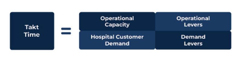

Takt Time Components
Takt Time matches hospital customer demand (in this case, the bedside cart replenishment) with operational capacity, and then plots out the flow. Takt Time is broken down by schedule per hour, allowing hospitals to establish measurable targets for on-time delivery and percentage capacity.
We will further explore how to establish optimal flow by examining Operational Capacity, followed by the levers used to match capacity with demand.
